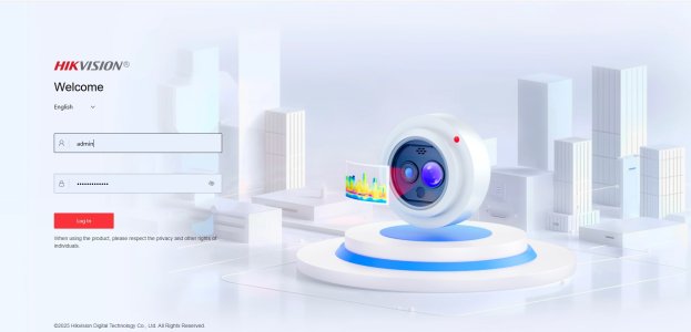

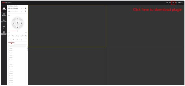

  1. Enter the device’s IP address in a web browser to open the login page.
  2. Enter your username and password, then click Login to access the camera web interface.
When prompted, download and install the plugin to ensure all functions operate correctly.

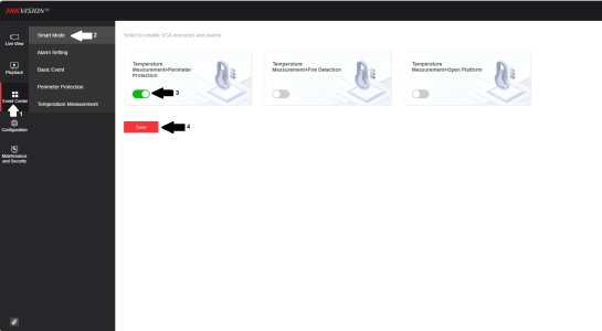

VCA Resource Configuration​
  1. Go to Configuration → System → VCA Resource.
  2. Ensure VCA Resource Type is set to:
    Temperature Measurement + Perimeter Protection
Click Save (camera may reboot).

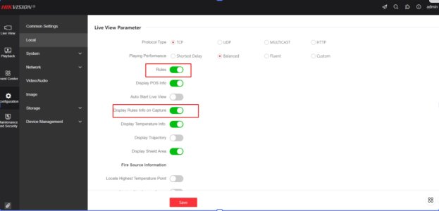

Enable VCA Information in Live View​
  1. Navigate to Configuration → Local.
  2. Under Live View Parameters:
    • Enable Rules
    • Enable Display Rules Info on Capture
  3. Click Save
This allows VCA rules and detected object information to be displayed in Live View.

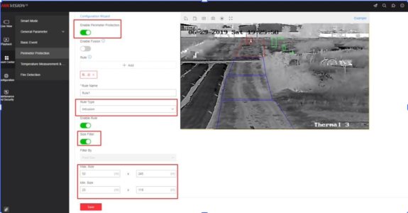

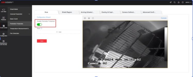

Enable Perimeter Protection​
  1. Go to Event Center → Perimeter Protection.
Enable Perimeter Protection.

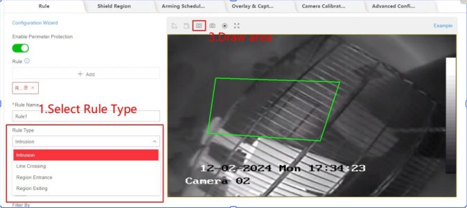

  1. Click Add Rule
  2. Configure:
    • Rule Name
    • Rule Type:
      • Intrusion
      • Line Crossing
      • Region Entrance
      • Region Exiting
  3. Draw the rule area using a line or polygon, depending on the rule type.

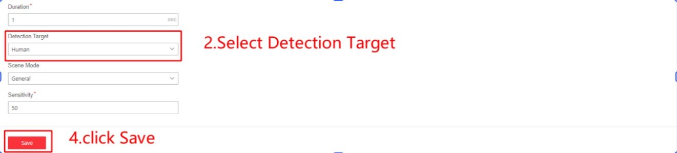

  4. Set Detection Target as required.
  5. Draw Minimum and Maximum Size filters based on expected target size.
  6. Click Save
Best Practice:
For each rule created, always configure Min and Max size filters to reduce false alarms.

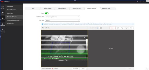

Camera Calibration (Alternative to Min/Max Size)​
Instead of using size filters, you may use Camera Calibration:
  1. After creating and drawing a rule, click Camera Calibration
  2. Enable Camera Calibration
  3. Select Self-Learning Calibration
  4. Set Filter Level:
    • Low
    • Medium (recommended starting point)
    • High
  5. Allow people to walk back and forth at least twice under the white calibration line
When the lines turn green, calibration is complete.
  • Click Pause to stop calibration
Or leave it running to continuously optimize detection (recommended)
