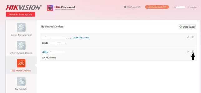

Hi,
Have you tried to delete on the hik-connect web page?
